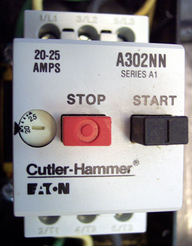

I aquired an older table saw. Its power cord was cracked and looking ratty, so I decided to just replace it all. I ran into a puzzle when I opened the switch up. Its a 220V motor. The switch has three places to put wires into across the top and three across the bottom, as well as the ground off to the sides. My thoughts were okay, wires will line up from each other, no biggie. But the switch has a wire that runs from the center top terminal around the switch to the far right terminal on the bottom, causing one of the cord wires to be crossed as well. This doesn't make any sense to me, unless this is done to activate something with in the switch mechanism itself.
Anyone shed some light on this for me?
Thanks.

Sounds like a mag lock style relay switch to me - thats what is on most higher grade table saws and tools that run on 220v - you know the kind of switch that has an on button and an off button . The reason there is a wire that wraps around is likely that the relay is operating from the line voltage, ie, the coil that activates the switch to lock the contacts requires 110 or even 220 to work. I have built my own mag locks on tools that only came with toggles to begin with, its a vast improvement. Actually was just at the local junk shop the other day and picked up a couple extra AllenBradley (good ones) on/off switch boxes (without the relay portion, but i have spare of those as well)
I would need to see a picture/wiring diagram to help you out here. They are fairly simple devices.

I need to run into Seattle for a couple of hours. When I get back I'll try to get a decent picture of the switch. I'm almost positive it's a mag switch. Its an older Grizzly cabinet saw. The motor is 220V only. Gotta run.

Can you take a pic a little further back, showing the wiring coming in .. its definitely a mag lock, and should be easy to wire in a new plug and cable. Is the existing plug a 3 or 4 prong ??? If its only 3, then its really simple as you basically have the two legs required for 220v and ground. There will be no neutral unless its a 4 prong. You should be making connections to the side with the terminals marked L1 etc. The T side terminals go to the motor.
PostPosted: Sat Jul 01, 2006 3:19 am
Cutler Hammers website shows the correct wiring for this manual starter when used for single phase.
Power is connected to L1, and L2
Motor is connected to T1, and T3
Jumper from T2 to L3
Yours is hooked up slightly different, but will work just the same. Just replace the two power leads where they came from ( looks like L1, and L3) leave the motor leads and jumper where they are, and you'll be fine.

The motor leads weren't connected, just stuffed in there. Which is what prompted me to post my question. I didn't even think about looking at their website.
